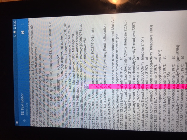

I tried installing and launching Nissan Datscan 2 onto my Android device that does not have a GPS module and I believe this maybe causing the application to crash at startup.
Is there any fix for this in the future for devices that are not built with a GPS module?
Have images of logs but it's too big to upload here

What device are you using? Are you using the latest version app?
We need to test it on a similar device. The app checks for a GPS provider at startup but something is obviously not working.
