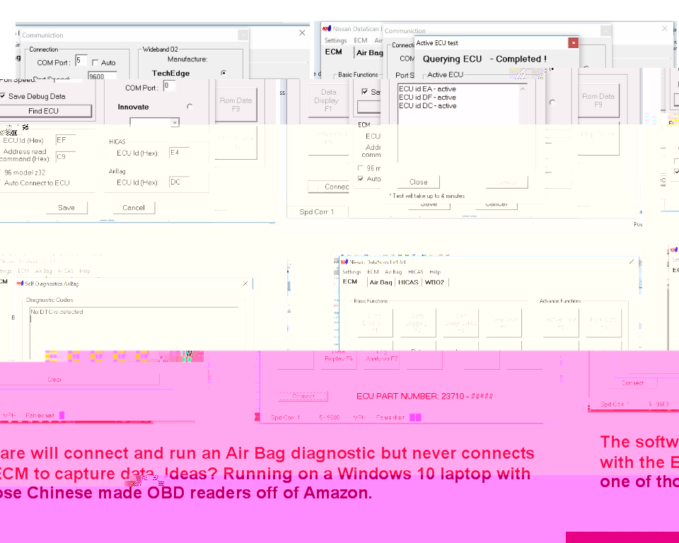

Can establish a connection to the ECU. The active ECU test completes ok. Clicking the Connect button for ECM does not establish a link. Clicking the Connect button for Air Bag does connect with the air bag dashboard light blinking plus the ability to run a diagnostic.
I have tried changing the port number but 5 is the only one that works. Also, tried the Auto connect option on and off. Using one of those generic Chinese made OBD1 Nissan readers connect to a Windows 10 laptop.

- noscan.jpg (148.37 KiB) Viewed 5351 times

It looks like your engine ECU is not responding to the connection requests. Try the "96 model z32" option just in case.

If you can connect to the Air Bag ecu the adapter must be working ok.
You have completed the Active ECU Test but the engine ECU did not reply. The ECU Id for engine ECU is EF. EF is not listed on the screenshots you have posted. It means the NDSI software did not receive a response from the engine ecu.
