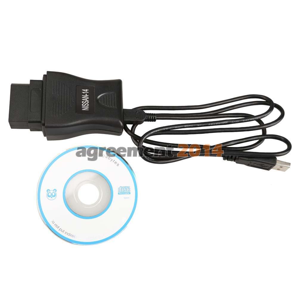

Im using an FTDI FT232R 14 pin consult USB to connect to my 1994 B13 Sentra GA16DE (PHDM). I can't seem to make it work. the app detects my FTDI USB but when I press on the connect button, it always says ini failed. am I doing something wrong or is the phdm b13 sentra ecu not supported? I really need to make this work so I can adjust my a/f ratio. thanks. I attached a picture of the consult usb.
- Consult-2-CONSULTII-OBD-USB-1989-2000-DDL-14-pino-ARE4.jpg (55.82 KiB) Viewed 10085 times

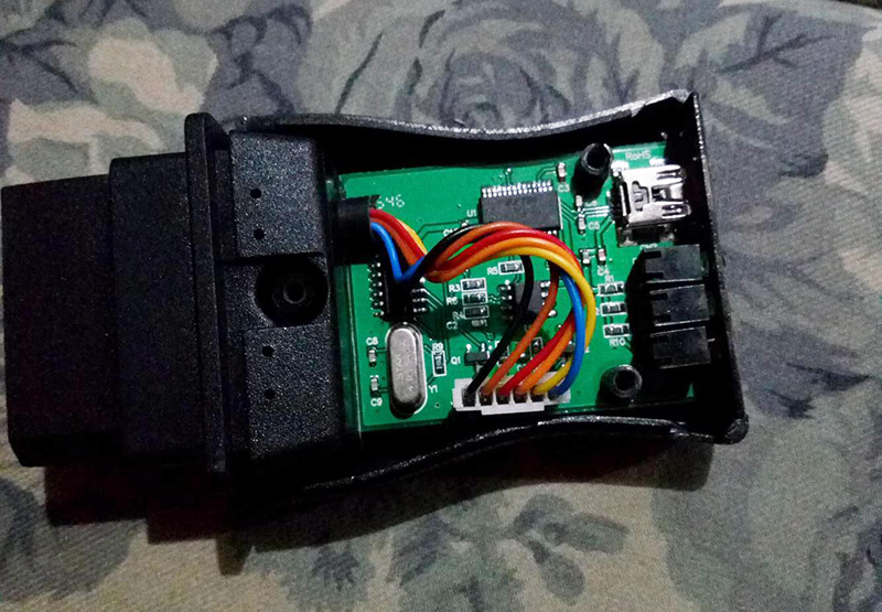

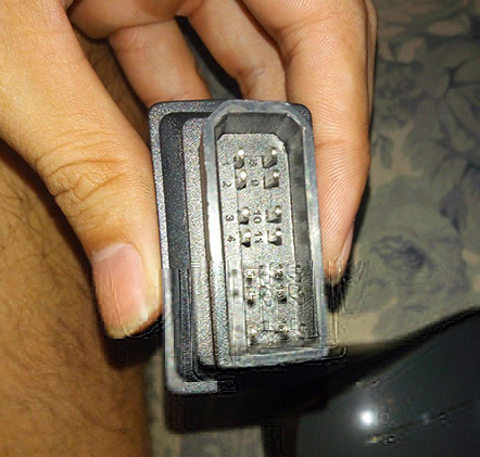

The wires are all good, i even tested it with a multimeter the port is even getting 11.7v of electricity. I opened the ftdi usb and this is what's inside. do you think this is a legit device or did i get ripped off? hopefully not the latter. thanks.

Re: FTDI USB not working
It looks like a legit device.
I had a look at the wiring diagram for your car and it looks like your ECU needs the clock sugnal from the adapter. The adapter you have should be providing the clock signal but sometimes you can come accross faulty ones that do not.
Are you able to measure pin 9 on your adapter to see if you get around 154KHz? This would confirm the clock signal is ok. (adapter might need to be powered from the car not just USB).
