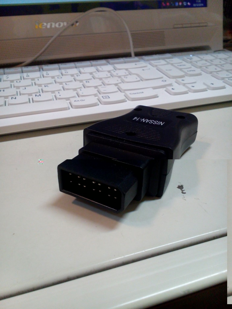

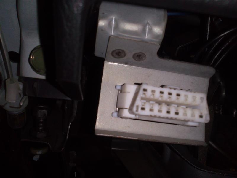

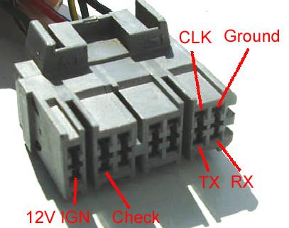

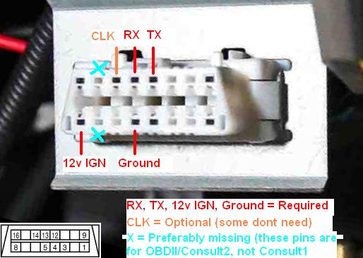

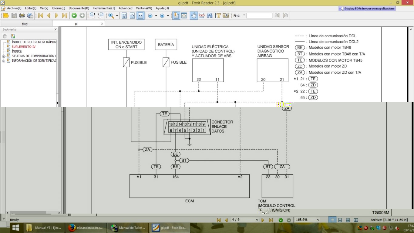

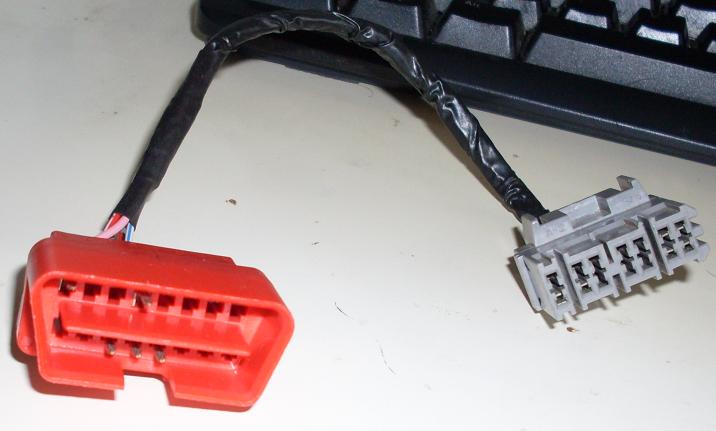

Hi Tom. I'll send you some pictures of what I have prepared for NDSI attempting to run my car. My car has a 16 pin OBDII connector. But the pins are in correspond with Nissan DDLI protocol. This protocol can only be read by a Nissan Consult adapter 14 pin.
As I can not plug my adapter 14 pin plug in my 16 pin, I had to make the cable that you see below. I have checked the pins of the plug that goes to my car, correspond to the pins where I plug my adapter Nissan Consult.
If I plug my adapter Nissan Consult in my car, do nothing. Just get it on, if I connect the USB cable to a laptop.
Photo 1: [attachment=2]Conector OBD.jpg[/attachment]16-pin connector of my car.
Photo 2: [attachment=1]Conector16pinesPatrol.jpg[/attachment]16-pin connector correspondence.
Photo 3: [attachment=0]consult_car.jpg[/attachment]14-pin connector correspondence.
Photo 4: Pin communication of my car.
Photo 5: Adapted 14-16 pins.
Photo 6: Nissan Consult reader USB 14-pin.
