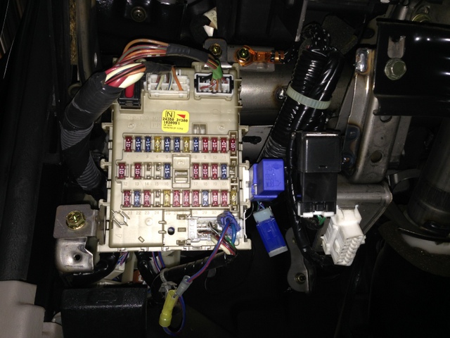

Yes I checked my 2000 Maxima for the 14 pin Consult connector and found none.
Attached is a photo of the fuse box area under the dash including the OBD2 data link connector.
There is no 14 pin connector of any sort.
I even double checked the connector directly below the fuses with some spliced wires coming out of it and it has only 12 openings.

As you can probably tell from my photo, I removed the plastic trim cover under the dash so I have good access and visibility of all of the wiring under and behind the dash and there is no 14 pin Consult connector anywhere, just the OBD2 connector visible in my photo.
