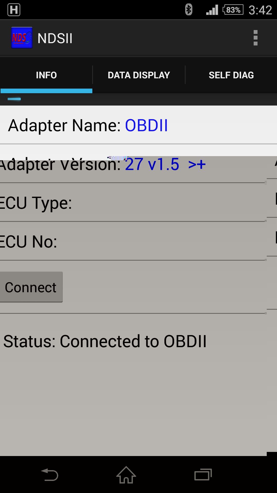

Can you post a screen shot of your failed connection?
Re: NDSII for Android released
Here you go.
- NDS_vanhack.jpg (114.47 KiB) Viewed 16904 times
OK. I think I know what the problem is. Does it always come up with this weird Adaptor Version?
yes, actually the second time I request to connect, it will drop the connection, then after that adapter version is not displayed, but shows "success>?"
