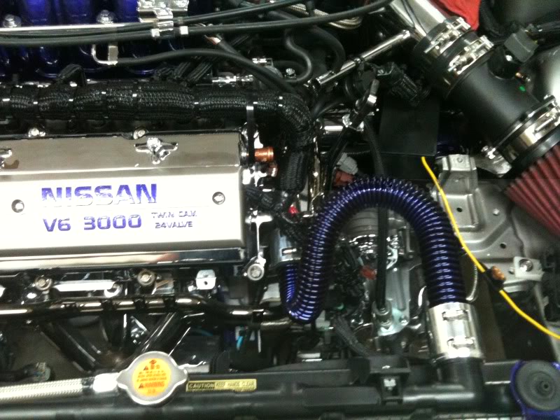

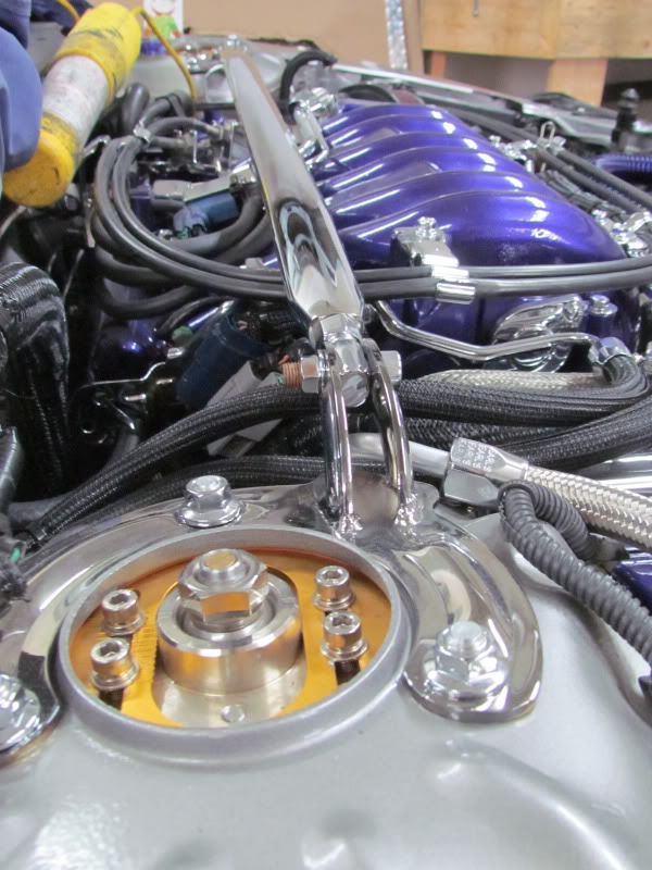

Hey Tom, thanks for the support. I will double check everything tomorrow.
In the mean time enjoy the pic.
- IMG_0080.jpg (103.13 KiB) Viewed 13295 times
- IMG_0519-1.jpg (97.99 KiB) Viewed 13295 times
