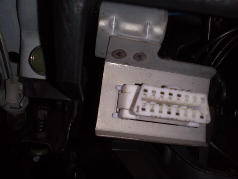

Hi Tom. This is a picture of my car OBD connector. As you can see, pins 7 and 15 for DDL2 (J1962) are not. From what I can assume, that NDS II, it will never work in our cars.
So, with that protocol working our cars?
Our car is a mixture of Consult I protocol with Consult II connector?
You could run NDS I, with conectror ELM327?
Tom thank you very much and greetings.

That confirms the diagram. Your car is still using the older Consult I protocol over pins 12, 13, 14.
You can not use an ELM327 adaptor.
You need a Consult I adaptor with an OBDII plug.

Thank you very much Tom . The problem is that the adapter type does not exist. I would have to make one .
He had thought of buying an old 14-pin connector and solder the wires needed to run .
This way , you would have the two connectors for OBDII diagnostic Niisan , and 14 pin connector to plug an adapter consultbt .
Re: NDSII for Android released
They do exist. Check the ECUtalk website http://www.ecutalk.com/interface.aspx

Hi Tom. I'll tranladar this thread, the forum NDSI. I'm making a cable to use my OBDII connector as if it were a 14-pin connector.
