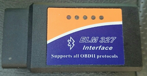

Hi Tom, the adapter I have, is one of the ones listed on the page that you have tested. What version did you test?
Attached is photo of actual adapter I have.
- IMG_20140530_070229_20140530070722021.jpg (110.76 KiB) Viewed 9412 times
Re: NDSII for Android released
Just bought a Bluetooth device as listed on your link, same problem. Software recognises the device, with version and Elm. But nothing else. Please confirm you have got these to work with patrol Tb48e engines.
Tom any idea why my second adapter, as you had recommended is not working as well. I have paid for the android app and can not use it, but hoping that there is a simple fix.
