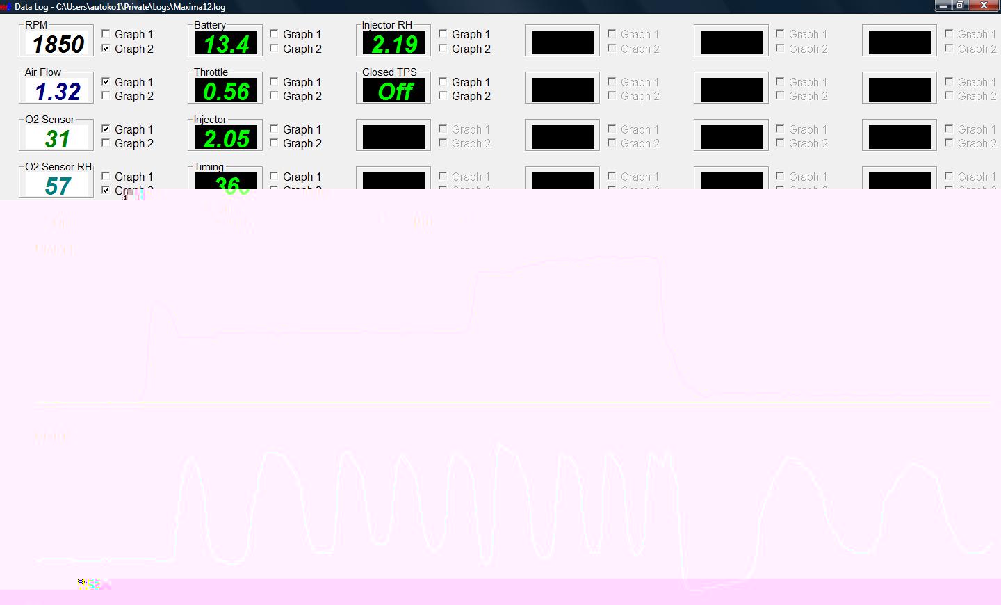

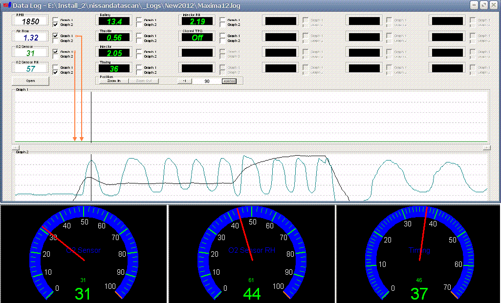

I have a question for displaying graphs.
Nissan Maxima A32. When I viewed in the mode "Log Analyser" will not show some of the parameters (in graphical mode). Although you, in Data Replay" I can see their values.
Why is this?

- A comparison between data display
- maxima_a32sum.gif (47.13 KiB) Viewed 5179 times

The O2 sensor is the green line at the bottom. It doesn't chnage in your log so it's just a flat line.
The Air Flow didn't show on your graph but it ame up fine on my ver 1.62.
[attachment=0]MaximaLog.jpg[/attachment]
- MaximaLog.jpg (157.23 KiB) Viewed 5176 times

Yes, this O2 sensor is "tired of living", but my question is: why is it data (31) displayed a line of zero (as the line for MAF-sensor)?

I have understood what it was. After the first cell of the column data of the sensor I replaced a value of 31 to 1. And his line signal "rise above."
And the graph has become like others.

OK, I know what you mean know.
Yes, the Data Display function scans through all data for each parameter. It then sets the lowest value at the bottom of the graph and the highest at the top. So if for example the log contains only RPM between 5000 and 6000 the 5000 values will be at the bottom of the graph and not 0.
