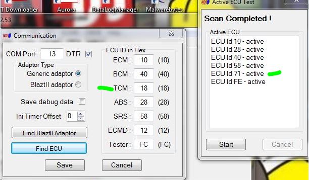

I have a question regarding the software in use with 350Z.
Firstly, I have done a scan of ECUs on my 350Z.
[attachment=0]ECU trouvés bis.JPG[/attachment]
The system does not show the ECU ID 18 normally for the TCM but it shows ECU 71, do you think I should replace 18 by 71 to get the right TCM ECU ?
Who does have a 350 Z to compare results in different ECU : ECM, TCM ABS SRS.... ?
Thanks & best regards

Hi Tom,
What do you think about ECU ID 71 instead of 18 ?
Posts: 611
Re: Nissan 350Z 2006 Phase II
Your TCM ID should be 18. Try adjusting the Ini Timer Offset rather than changing the ID. Try positive and negative values and try connecting every time you make a change.
You will only be able to connect to TCM if your car has an automatic transmission.

ok thanks Tom
I have a manual transmission.
