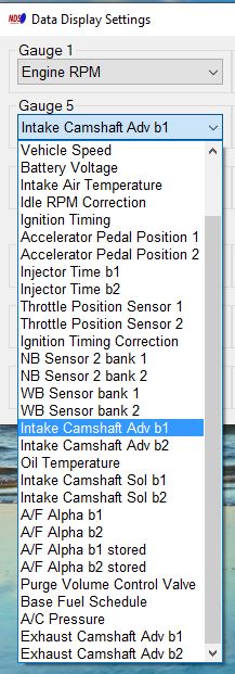

When in the Data Display Settings window and you open the drop down list for one of the gauges, do you have "Intake Camshaft Adv b1" listed?
[attachment=0]Intake Cam.JPG[/attachment]

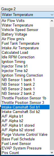

Negative, all I have is the Intake Camshaft Solenoid.
However, when I go to ECM > Parameter settings, I see "Intake Camshaft Adv" as a listed option.
I have a persistent P0021 after my rebuild. I took the front and rear timing covers off, found an oil gallery blockage, and removed it. However, the code still persists. It would be nice to be able to see the difference between the two intake cam angles to help me troubleshoot the problem.

Posts: 605
Re: Intake cam angle?
If it's not listed then it means it's not supported by the ECM.
Parameter Settings function lists all ECM parameters supported by NDSII. Whether they are supported by your ECM or not.
